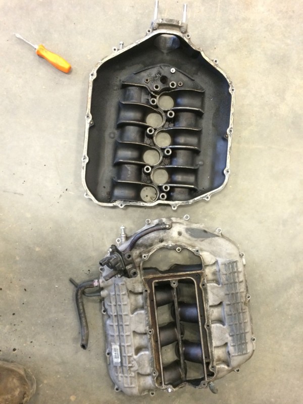

some cleaning
MyLevel
Posts: 28
Joined: February 19th, 2015
Re: 3.7 IM project (Props to @ccord10)
by MyLevel » March 19th, 2015
Now that i see the inlet is only 67.5 mm i believe that the 07 mdx manifold (even though it is the 3.7 liter) will not be much of an upgrade. I read here that this guy has measured his newer 3.7 and it reads 75mm... big difference.
