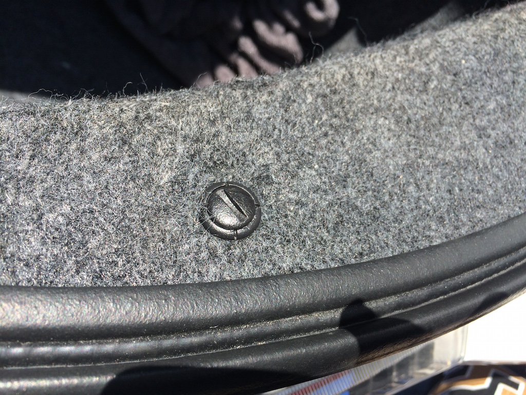

but do you guys have any tips/secrets on removing these suckers?
i managed to remove ONE (on the opposite side) the "correct" way by unscrewing the actual screw piece and pulling the rivet(?) piece out. but i had to yank the other thing out because it wouldn't "unscrew"... and neither will the two on this side.
i should also mention that i did successfully replace that tail light bulb, but i can't get those two clips/rivets/screws/whatever to go back inside... i don't want to use brute force because i don't want to break them (provided that they're not broken enough already... which they probably already are) so just pushing them in wasn't working. i also tried unscrewing the screw from the rivet but the screw wouldn't............ unscrew! lol.. maybe i'm doing something wrong, or maybe i'm just tripping because its cold as heck out. lol.
anyways... any tips, suggestions on how to remove/replace these things is very welcomed!

To get it out if you can't screw it out is to push down the bottom piece while pulling the screw part up and unscrewing it at the same time.

Yeah I didn't have any trouble out of these at all when putting my Eagle Eye LED tails in. Using a normal screw driver the all screwed right out, and then was able to pry the "rivet" piece out gently with a small screwdriver.

LOL!!! Its around 50º today so it was optimal about an hour ago. I managed to take the screws out of the clips I had already taken out, and replace them properly. To get the other two out (on the left side), what I did was put a flathead screwdriver inside the space between the screw and the clip and pried up a bit to where I had enough leverage to unscrew it with my hand and pull it out. In doing this, the clip itself popped out, making things 100x easier. Took the old bulb out, put bulb grease on the new one, put it back in, and put everything else back together. I also had to tuck the trunk lining back under the rubber seal for the trunk.. it looked tacky without doing it. Which reminds me... I have to do this for the right side :x
