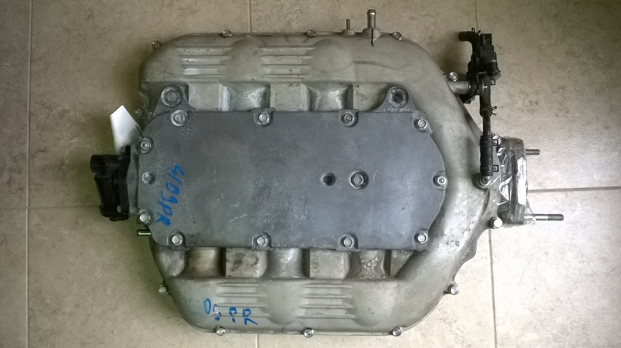

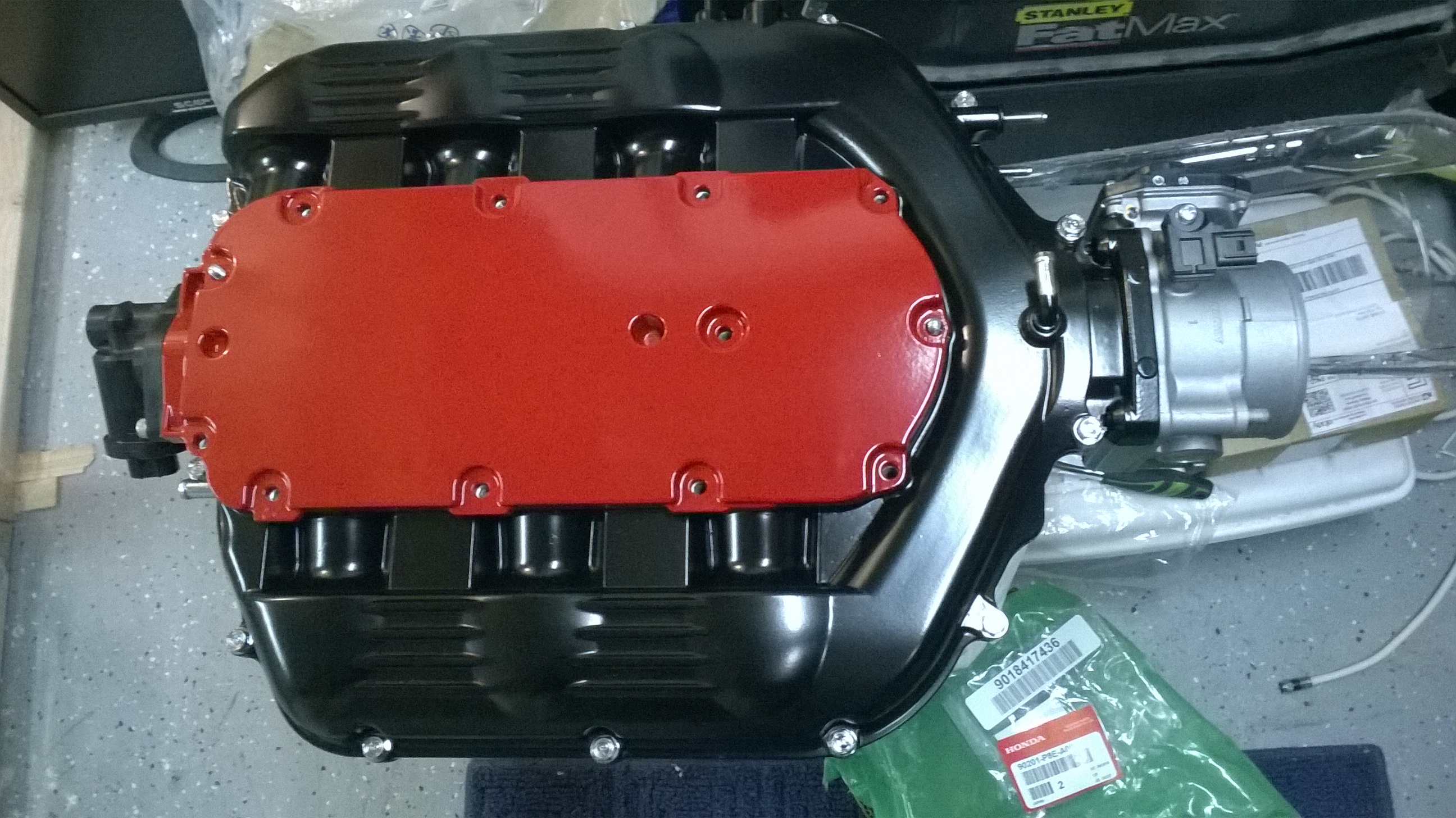

After feeling the difference my MDX riser made i needed even more so i ordered a ZDX 3.7L manifold and TL-SH throttle body. i also got the cover with IMT valve for even more torque, eventually i will build a circuit to make it functional to help power above 4k rpm's. I got my manifold used so it required alot of cleaning and some cutting/grinding to reshape the cover since it will be exposed, but i couldn't beat the deal.
this is how i got it
After some cleaning and paint
ready to install

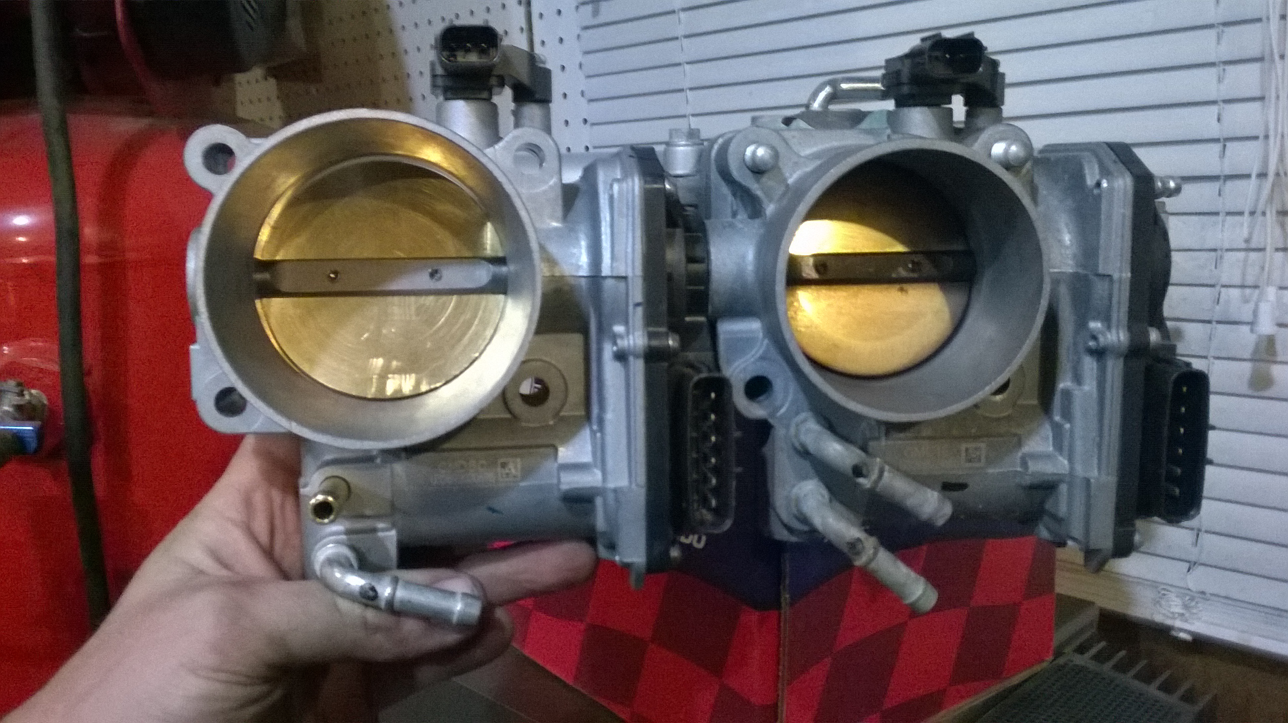

TL throttle body is huge compared to stock

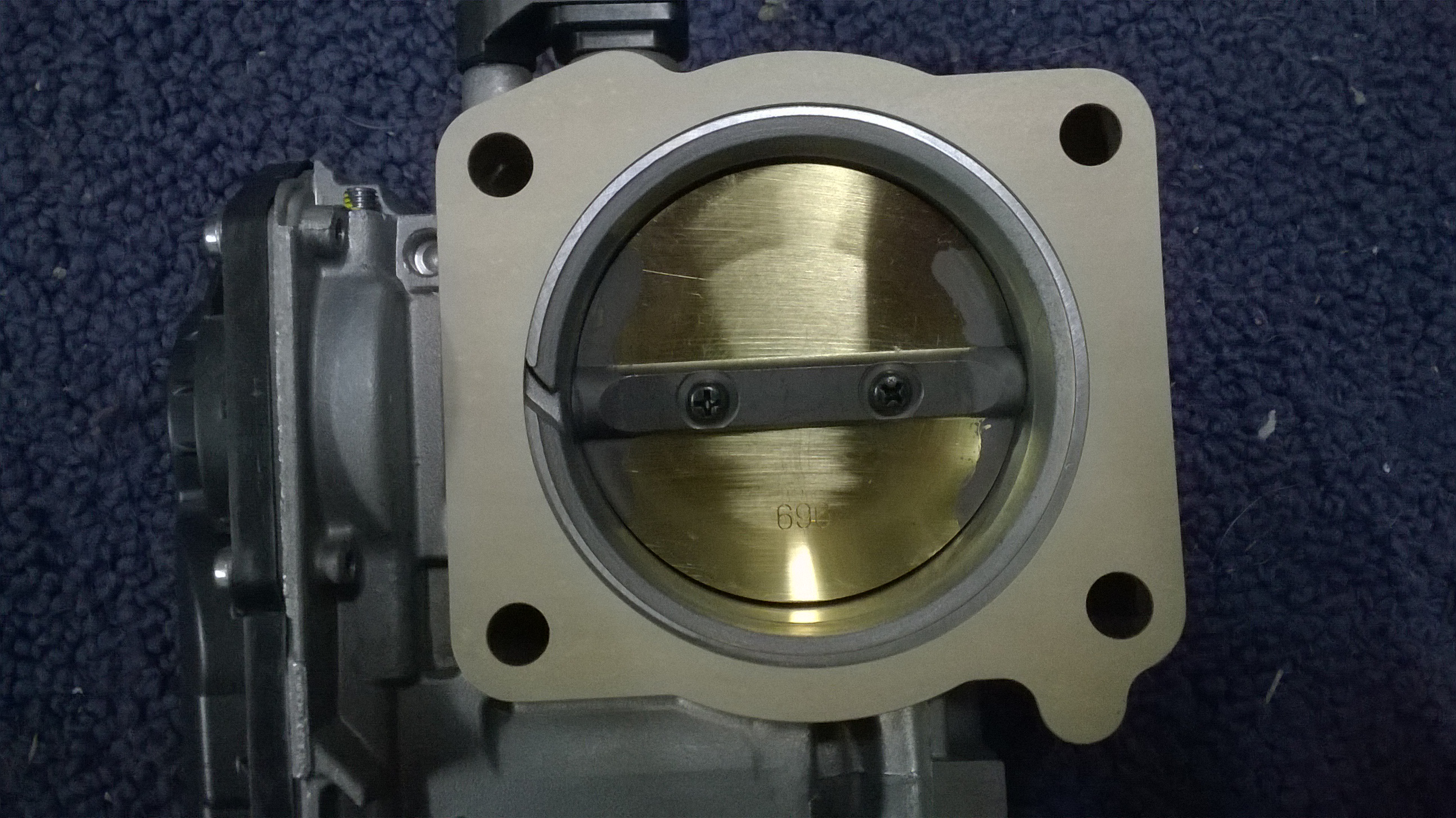

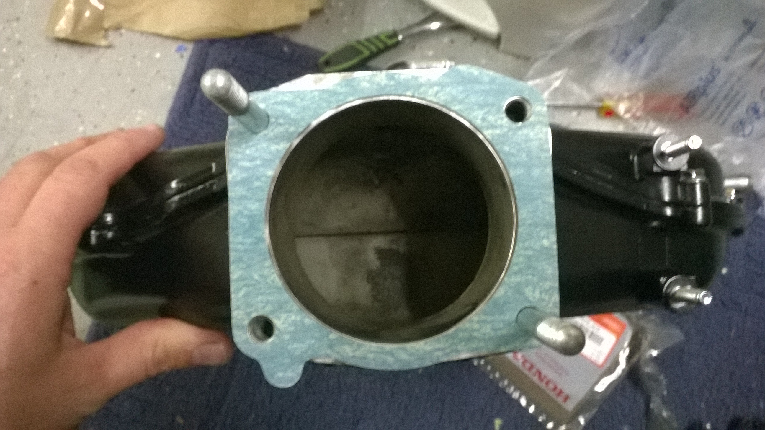

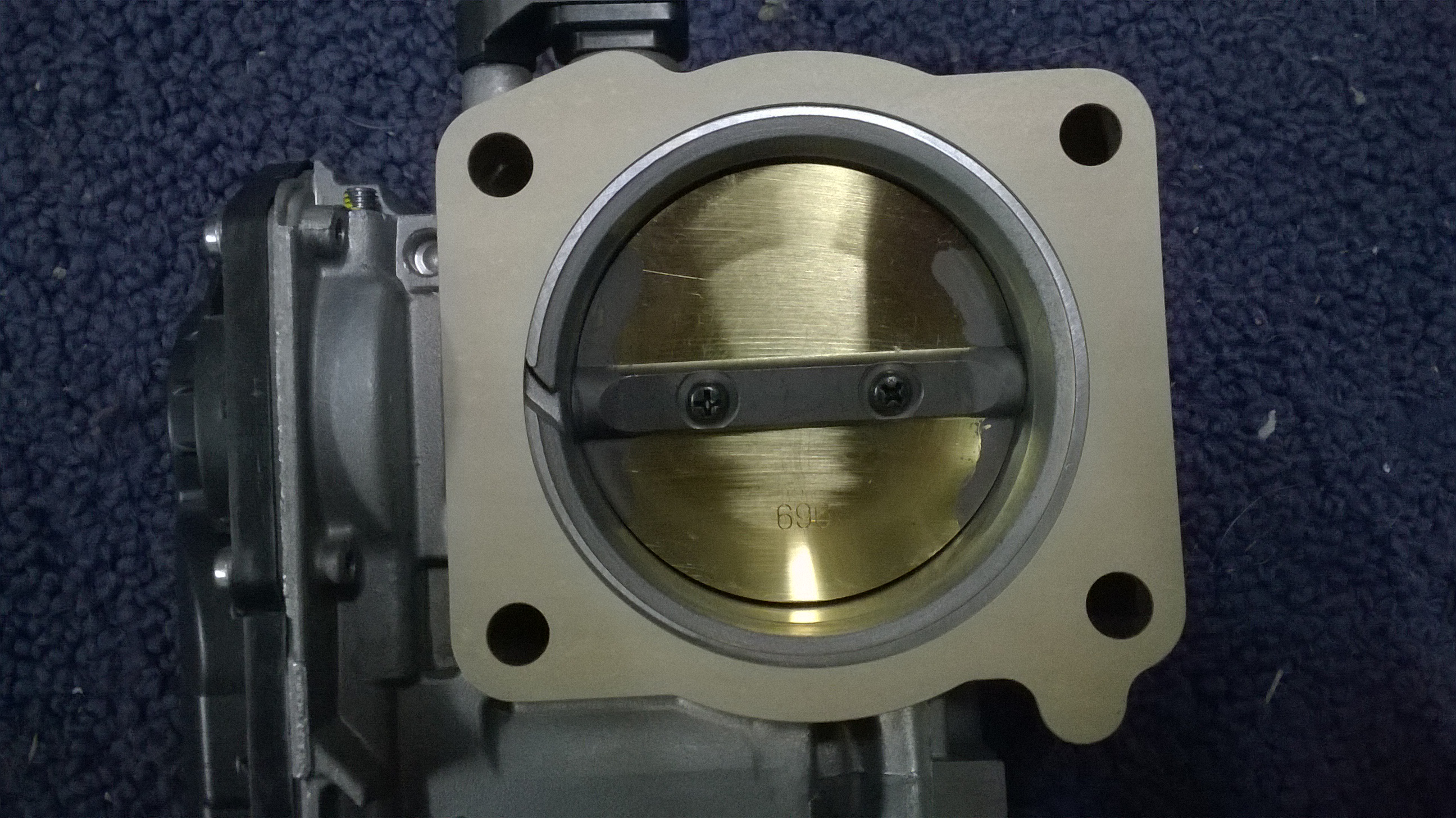

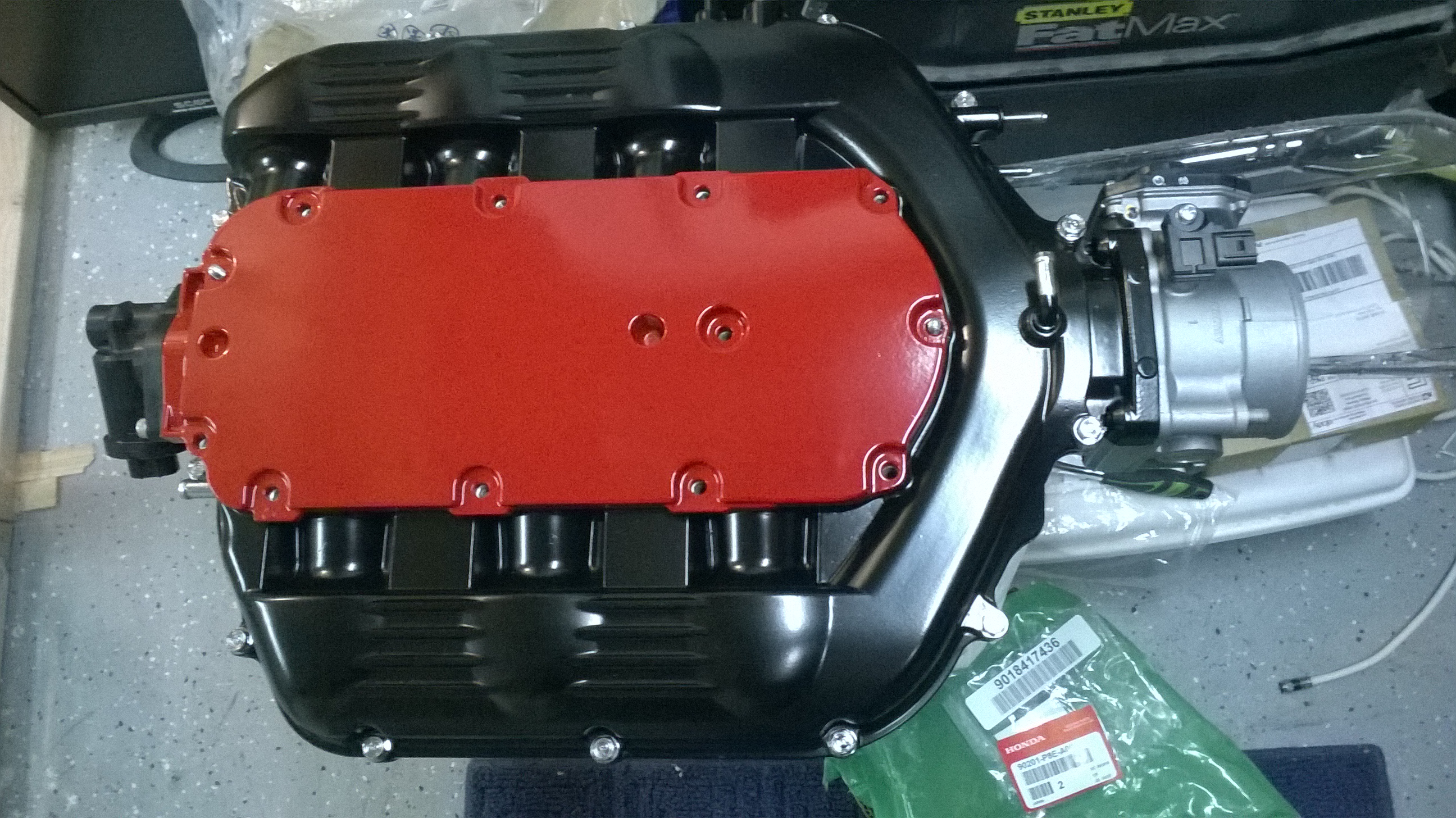

heres some shots of the manifold and throttle body with gasket to show how close the bores match, no need to port.
manifold
Throttle body

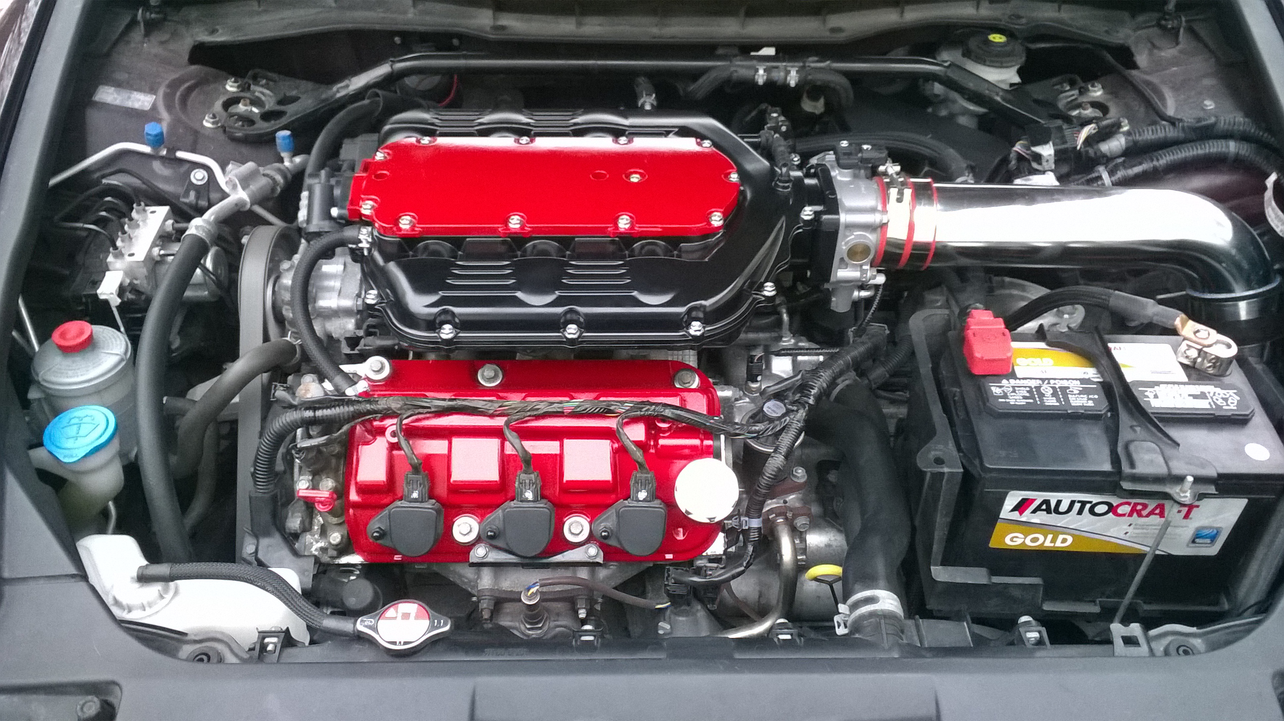

everything installed :D I've got some parts on order to cover the coil wires and dress it up a bit
The result was totally worth the effort and cost, power is amazing throughout the rpm band and its super responsive now. i cant wait to get it on the dyno to get some numbers but that will have to wait for spring. Good thing gas prices are low now because i cant fight the urge to stab the gas pedal every chance i get, it always puts a grin on my face. The only downside is that my intake doesnt have the growl it used to have so ill have to upgrade my exhaust to compensate.

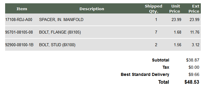

here is a list of parts needed for the manifold riser, automatic coupes do not need the milled riser but 6-6's will . 6-6 coupes may opt to get the P2R manifold riser instead so that no machine work is required. i ordered my manifold riser parts from hondapartsnow.com they accept paypal.

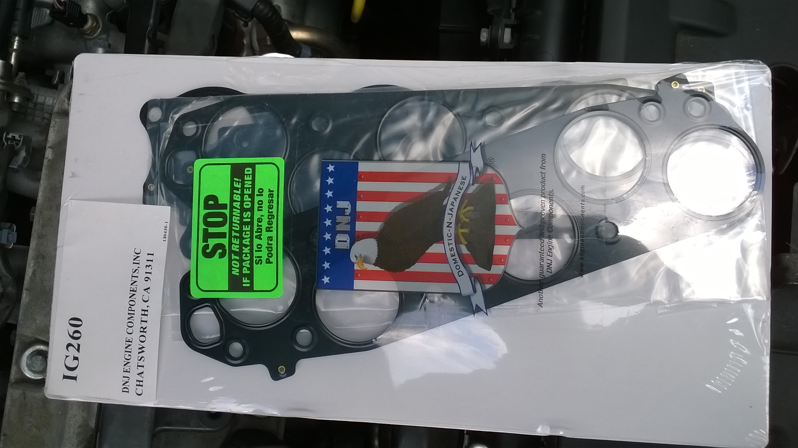

you will also need a gasket for the riser, i ordered this set off ebay was around $25 search for IG260.
gaskets
