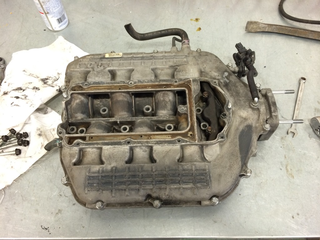

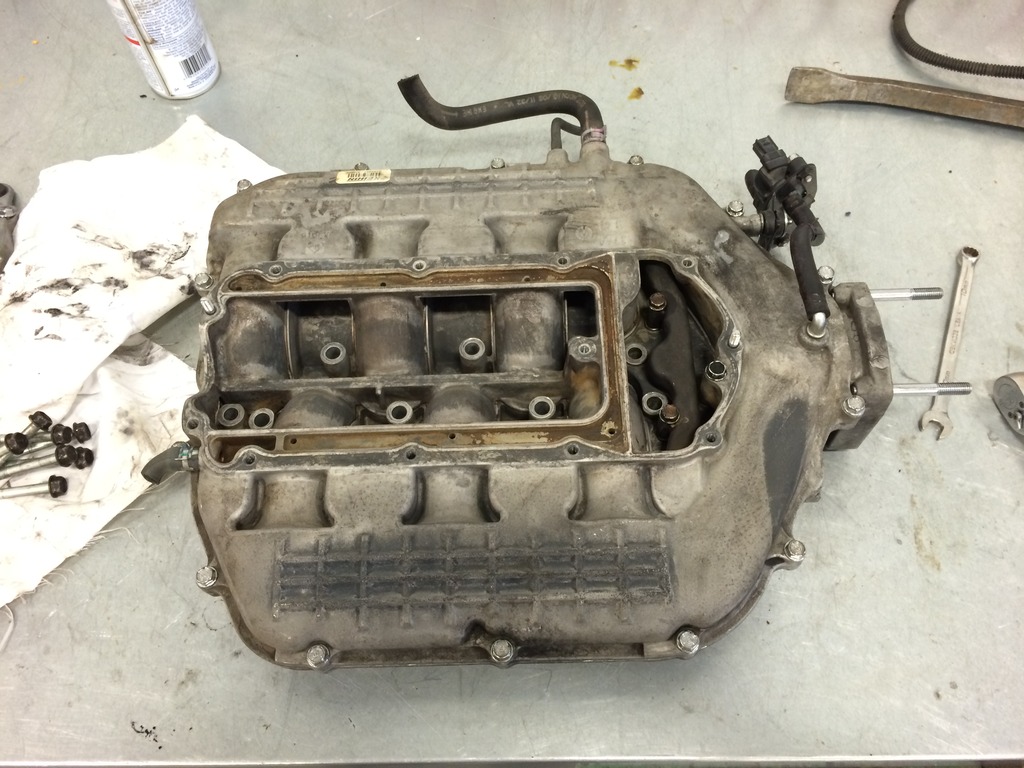

here is my mdx from the 07, yes its the 3.7l.
