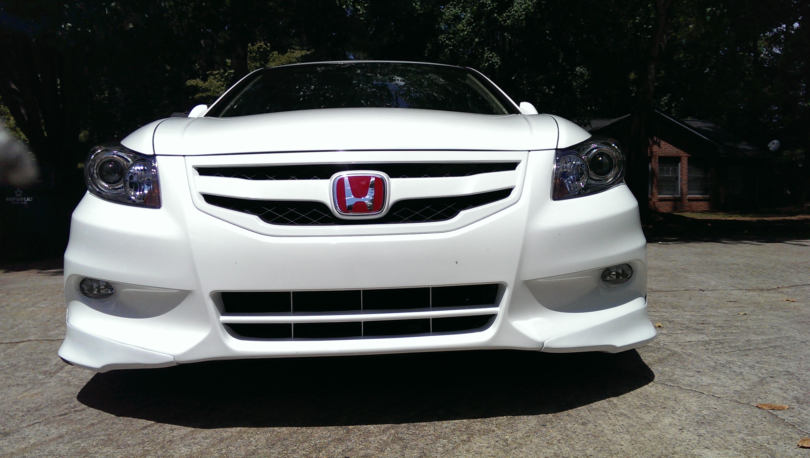

Of course you can. No need to remove the reflector bowl really though. DOOM just posted the other day his quad retrofit. It's pretty impressive. Lots of people (myself included) will just go with the Morimoto Mini H1 as it's one of the easier ones to install.
Here's a shot of my retro. Pretty simple setup.
