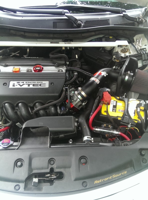

Photo cred to Bigwilly
What is a SRI?
SRI is a Short Ram Intake. It's main function is to draw air quickly to the engine but less restrictive than stock.
Where does the filter sit?
In the engine bay typically. For the 8th Gen application it sits right behind the battery.
Benefits of SRI:
Slightly more power in lower spectrum of rpm range. Air gets to engine quicker. Less prone to hydro-locking engine. Lighter weight compared to CAI and stock.
Negatives of SRI:
Sucking in warmer air compared to CAI. Air is less dense. Some intakes comes with a heat shield to block off engine bay air. Some people build a custom heat shield.

Artema wrote:Image
what pipe are you running? Thats different for the V6. Is that your battery tie-down? lol
