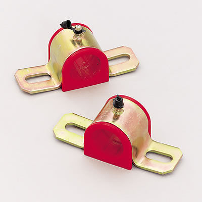

Posted: January 17th, 2015
by @ccord10
i found these greaseable polyurethane bushings from energy suspension on E-bay. since ive heard that bushings start to squeak after awhile and i dont want to take them apart every time to grease them i picked up a set. they have them in just about any size you need and they were only $20.
