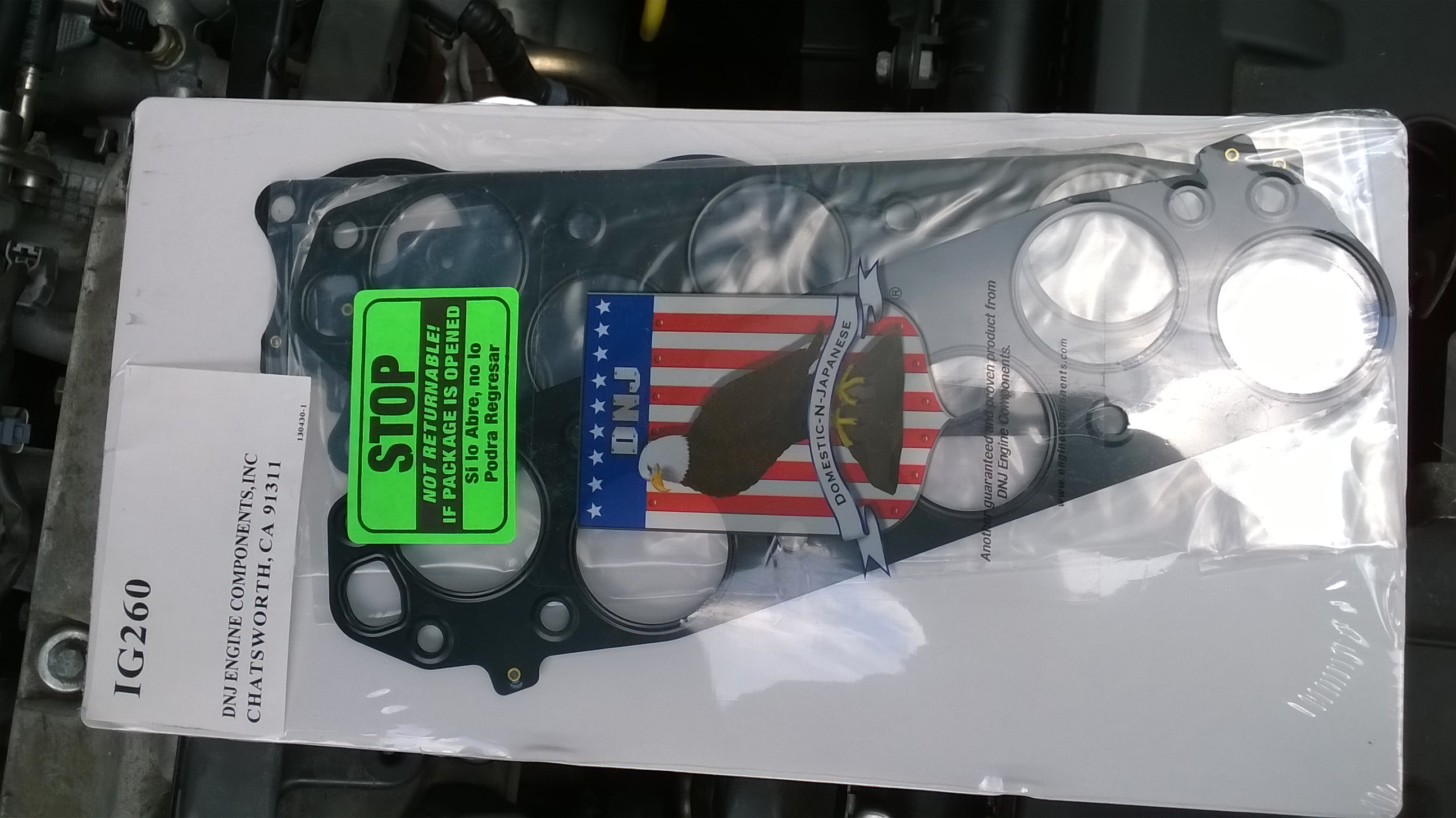

you will also need a gasket for the riser, i ordered this set off ebay was around $25 search for IG260.
gaskets
